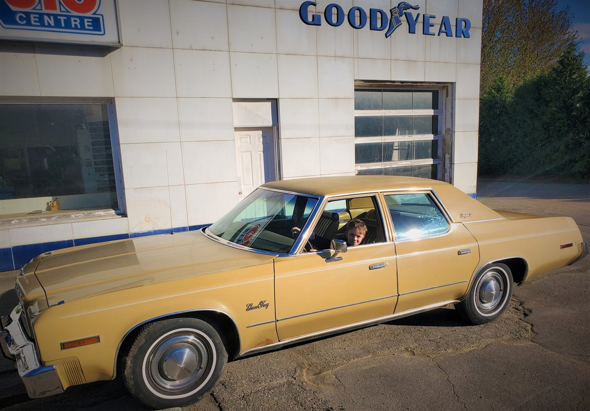

![https://i.ibb.co/Xxy9ccv/att02.jpg](https://i.ibb.co/Xxy9ccv/att02.jpg) ![https://i.ibb.co/v190Qv2/att03.jpg](https://i.ibb.co/v190Qv2/att03.jpg) ![https://i.ibb.co/SQRvL5m/att04.jpg](https://i.ibb.co/SQRvL5m/att04.jpg) It was the day before Mother's day 2021 when my son and me took via rail for the first time of our lives to Windsor, ON, to pickup the Fury. The interior was absolutely mint, the vinyl top was mint, the paint was shiny, I couldn't find any rust with the exception of some surface rust in the rear lower wheel well lips, but that was about it. Had it not been 44 years old, I could have sworn it had some new car smell left in it...Lies :-) New Delco battery, new magnaflow muffler, new Edelbrock carb, Edelbrock aluminum intake manifold, fancy 90s stereo that plays Blues Brothers CDs through one center front and 2 rear speakers, decent tires, and many more positive surprises. The car is from the US. It was owned by the original owner until well into the 90s or early 2000s - in Minnesota - sold by Rosemount Chrysler/Plymouth. It must have sat in the garage for years. The seller and me came to an agreement, he disclosed that there's a small rad leak, and we went straight onto the 401 heading Eastbound to reach the 300km radius for CAA to give me a free tow. ![1st day](https://i.postimg.cc/nL6y0DPN/20210509-013617-2.jpg) First time on the highway...like a grandpa at first, but what a smooth ride! ![speedo](https://i.postimg.cc/fR1qNhf9/20210508-170611-2.jpg) For the next weeks my son kept polishing the car and asking me when we start tearing it apart and making it a Bluesmobile - while I was trying to find an answer to the question if I can "destroy" such a nice car with original paint and flawless vinyl top. I made the mistake to post on a C-Body group and got ripped a new one. This wasn't an easy decision, but after finding out that a nice C-body isn't worth much, and that Chrysler isn't GM where a boxy Caprice in questionable shape sells for 3 times as much as what I stole the Fury for, AND that my rear quarters had been redone (so not all original paint etc) - I forced myself to see the green light and started with my little man to convert into a Bluesmobile. After all - I bought it to create some memories with him, to have a great time with him and maybe to have a first car for him, too (if he chooses his place of work/school etc wisely, so he can walk instead of paying these prices for gas) I'll continue in the next days with more pictures and good/bad experiences. Thank you all for reading!

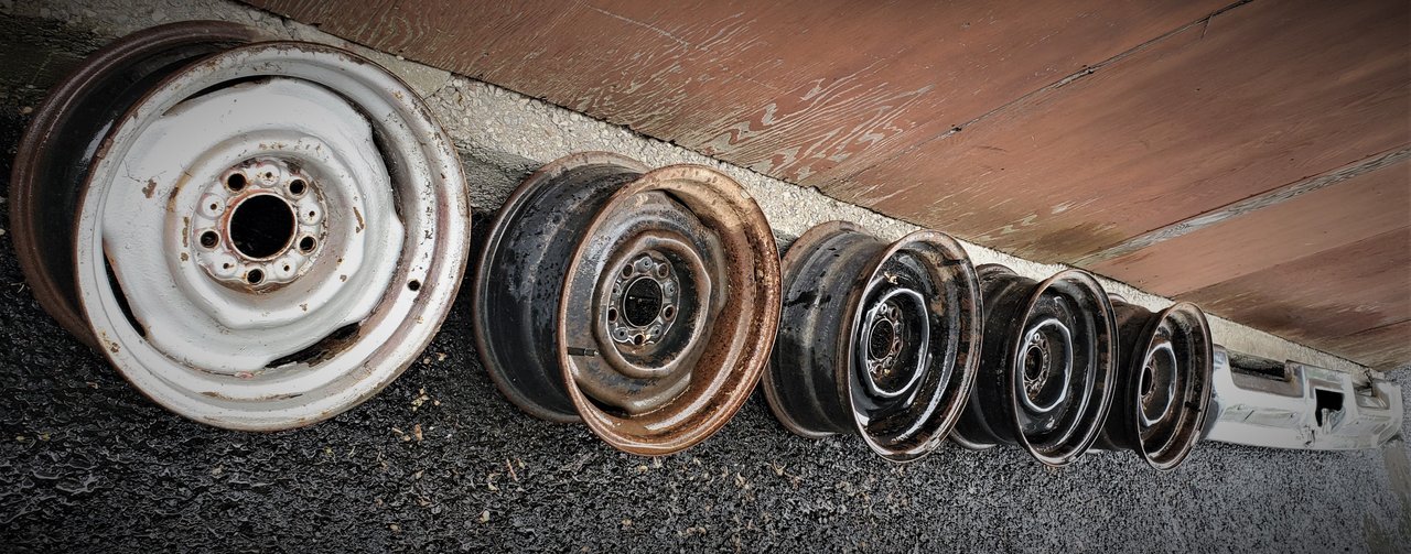

PART 3: Wheels: Steel and SteeringNothing bugs you more in your C-body than an ugly 2 spoke steering wheel and tiny wheels, the so-called pizza slicers. It literally represents the "malaise era" of Detoit cars of the 70s after the fuel crisis, barges in different brown tones with huge engines that barely put out 140 hp. That's NOT what you want. Your sleek - soon-to-be - Bluesmobile in elegant black and white, able to outrun the Police themselves, deserves an appropriate steering wheel and solid steel wheels that can't only take a beating, but also a beefy tire. I read somewhere about correct wheel sizes for Bluesmobiles being what I already had, the 15x6 steel wheels, but there seemed to be room for improvement. When picking up the above mentioned header panel, I also bought a set of early 70s Police wheels in 15x7. The inch difference doesn't sound like a game-changer, but the looks do. Especially wrapped in the 245/60-15s I had here, they might not be tall enough, but I say we shaved about 30 years off her age! What looked like the once-a-week ride for grandma to bingo, is now the daily driver of choice for the 30 year old, slightly dirty librarian... Above: The Donor car for our steering wheel - A relatively nice Cordoba
Below: The steering wheel after a thorough soak and clean, and a few coats of SEM (also visible...the tiny "trim slots" in the horn pad and the tissue on the bottom spoke to keep the horn pad out, since I lost one of the 3 springs in the process...)![steer](https://i.postimg.cc/g267TJbh/20210601-195220-2.jpg) ![wheels](https://i.postimg.cc/MHC7Mz3k/20210528-140615-2.jpg) I found a junkyard less than an hour away that didn't only have 30s-80s cars in the back third of the yard, but they also let in customers UNDER the age of 18, so "Doctor Myles" and me went regularly to that yard (Newtonville). Not only did we find a St.Regis and a 75 Cordoba (that we took the movie-correct steering wheel from - for $40) but much to my ...cough...amusement...cough... my little guy found a stash of old Playboy magazines in a Dodge conversion van. He found it was hillarious, me too, mommy not so much after we brought one home. ![https://i.ibb.co/xz0GGGq/att12.jpg](https://i.ibb.co/xz0GGGq/att12.jpg) Back to the steering wheel....there was an aluminum cover with wood print on the center that we took off carefully, but it left tab-holes in the horn-pad that are quite visible if you look closely. I might give this aluminum trim piece a good sand, re-install it on the horn-pad and paint it again. We dyed the steering wheel with SEM paint (and it's holding up great!) while having our 15x7 police wheels sandblasted. I can't recall any GM police wheel being THAT heavy, they really are solid. Back from the sandblasting, we immediately primed them and gave them a few shots of semi-gloss black, they looked like BRAND new. ![https://i.ibb.co/BsHrt4N/att13.jpg](https://i.ibb.co/BsHrt4N/att13.jpg) ![https://i.ibb.co/sFFbTPz/att14.jpg](https://i.ibb.co/sFFbTPz/att14.jpg) In the meantime we found out that our C-Body always seemed to be magically drawn to photo-ops in front of churches... ![church](https://i.postimg.cc/7L2HHw88/20210524-155329-2.jpg)

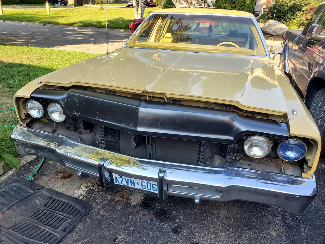

PART 4: The header panel.I did a lot of research to find out what is possible - and what isn't - and although information on Chrysler C-bodies - or Chrysler products in general is scarce compared to the wide variety of GM information that is all over the internet (I had a hard time finding out which model fuel pump bolts onto my 360 SB, as none of the parts stores - including rockauto - had ANYTHING. Mind you - I'm a GM guy and probably quite spoiled when it comes to availability of parts, used or in junkyards...). I found pictures on the Internet of a black "Furaco" - so it had to be possible. I have yet to find a "Furaco" with Monaco rear bumper/lights etc, but I know NOW that there's a lot more to it, but more to that later. My little man wanted to see results and kept talking about "buying a Monaco" when we see one, so the time has come for the header panel swap. I sourced the headlight brackets from a 74 Monaco coupe in Alberta that was sold in parts, I already had the grille, header panel and light trim, so off with the old.... ![https://i.ibb.co/K6D1N1g/att19.jpg](https://i.ibb.co/K6D1N1g/att19.jpg) ...and on with the new! It was honestly a lot easier than I expected, however, the Gran Fury fenders are shaped slightly different in the front, it took me more time to adjust the headlight brackets than anything else together. And yes, I'm not re-installing the "Dixie" horn into the Bluesmobile... ![nose99](https://i.postimg.cc/7Lxnhvgh/20210723-175640.jpg) ![https://i.ibb.co/nzm1ThD/att18.jpg](https://i.ibb.co/nzm1ThD/att18.jpg) It's hard to believe what difference a simple "nose-job" can do. The only problem that arose was - now I had no marker lights, but more to that later - you might see my temporary solution in the avatar... I'll eventually have to change out the bumper and build/mount a push bar to perfect it, but for now the little man was so happy, he had a "Blues Brothers Shrine" put together on the living room table - minus the smoke, I added that... ![https://i.ibb.co/pd7BbfL/att17.jpg](https://i.ibb.co/pd7BbfL/att17.jpg) I don't mean to brag, but isn't it awesome/cost effective when you get to buy your son for Christmas and his birthday the things that you've always wanted anyhow and everyone is happy? Win/win/win situation: you spend your hobby money on birthday gifts and the wife can't complain...talk about killing two birds with a stone or a few overpriced model cars :-)
