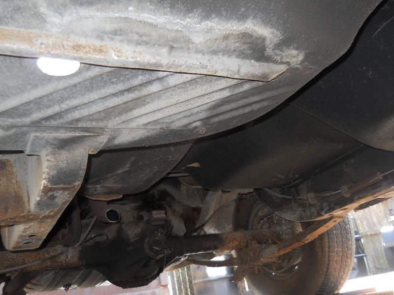

Well I took the car out for an actual drive today. The weather was nice so cruising with no windows was not a problem. It was great! The car handles surprisingly well, the biggest problem was the straight pipe exhaust and the TF727 that has the performance of a centrifugal force clutch on a go kart. I also got the car in the air and got some pictures of the undercarriage. Crazy cool straight pipe exhaust and dented tank Fake duals 8.25 rear....I have a line on a 9.25 Torqued up torque box. Arthur, I am interested to get your ideas on reinforcing this area. Sloppy Idler arm Leaky steering - a stage 1 Firm Feel box will look nice there solid rockers rust free quarter lips and dog legs front inner and lower fender I was surprised to see that the sub frame rubber mounts looked this good Shift linkage skid plate goes here, it was in the trunk Again, I am very happy with the condition of this car. I am so glad to have a fairly solid car to start with. Hopefully next week I will have some pics of thing actually being fixed!

Torqued up torque box. Arthur, I am interested to get your ideas on reinforcing this area. ... Sloppy Idler arm ... Leaky steering - a stage 1 Firm Feel box will look nice there For torque boxes, right now all I know is that I want to do something to mine. But I don't think I'll have any more ideas until I actually dig into mine and see how I'm going to to subframe connectors and tie it all together. For idler arm see the Mopar Action article here: www.74monaco.com/on how firm-feel replaces the bushing with bearings. I spoke with Dick of Firm Feel, and he can do the same upgrade for a 74 Monaco idler arm, but he hasn't done one yet. And an article on that same page shows how firm feel provides sector shaft support for the steering gear. I sent my Marin County steering gear into Firm Feel and had it done up per the "barge massage" article on that page. I also got new torsion bars. I'll be selling all these parts, new, at 1/3 off what I paid, as my build plan has changed and I won't be using them. So give me a bit to go through what I have, and I'll post it on the parts for sale section. I'm guessing that a lot of what I had originally planned will what you'll be doing on yours. your friend in new parts on old cars, arthur
