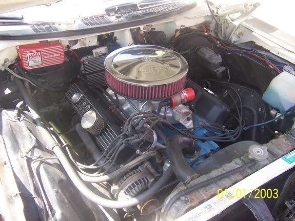

As you say 58, to each his own. I've heard countless testaments that headers suck, for the exact reasons stated above. Obviously I cant argue/deny that. I have seen some that leak, and know it is a bear to get them to seal up, and stay sealed. I can say, I havnt owned dozens of mopars, I've owned a few. The only one with headers was the best one I owned out of all of em, and that was my newport. I must have got real lucky with that car. That car came with the shumacher tri-y headers, full 2.5inch dual exhaust, with an H pipe. That car didn't sound tinny to me at all. Then again maybe it does to others.. When you say tinny, I automatically think ford 5.0L.. Also never had any problems with them rotting out, dragging, or what not. Hell they were left uncoated, bare, and the car sat outside in the elements with all the moisture. Never had any problems with em.. Here they are the day I bought the car Here they are 5 years later a month before I sold her. Sure a little more surface rust. But no rot. I miss that car!! I dont think we have to worry about draggin headers in these cars. They sit pretty high.... Sure you can spend all kinds of $$ on the stock HP manifolds to make em try to perform like headers. I'd rather just buy the headers. But thats me lol. We all have our own ideads of what to do.
