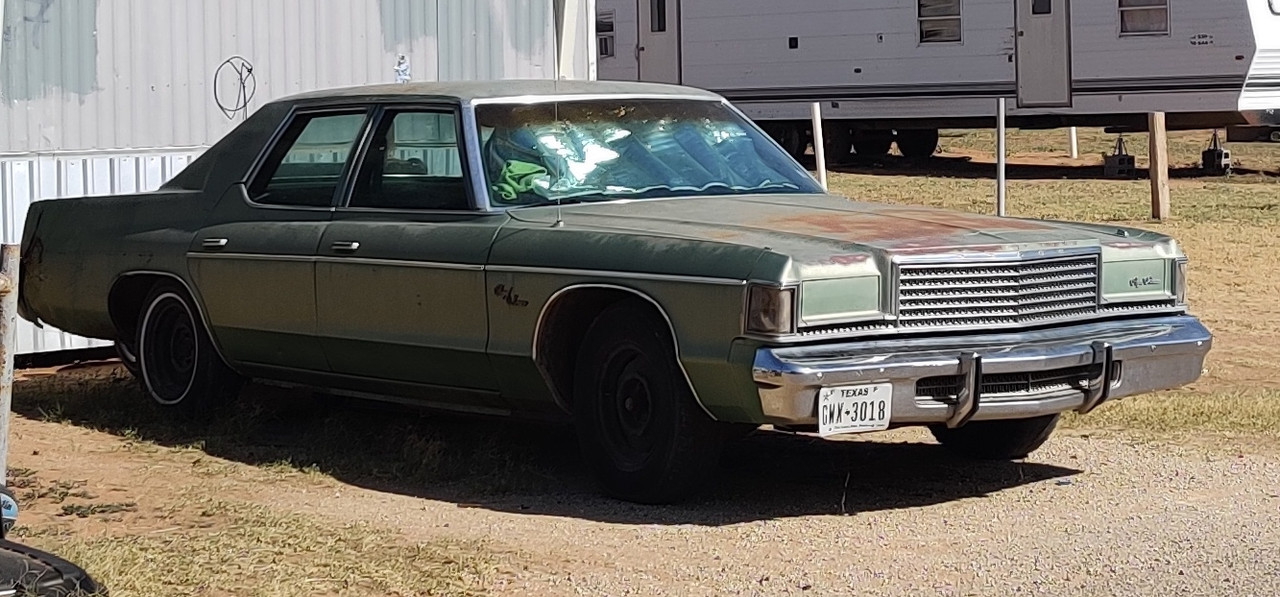

I am not an expert with difference of 75 and 74. If your blinkers are in the bumper then your fenders should be right. No need to ship this doghouse? Phish It's a Royal Monaco so the fenders are wrong.
Post by spyphish on Aug 1, 2020 18:14:48 GMT -5
Do auto headlight doors open and close? I can look at Lemons 24 car in AM see where that goes.
Post by flcl64 on Aug 1, 2020 20:50:51 GMT -5
They did in Texas. The battery is dead and I haven't tried since.
