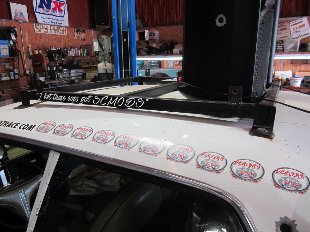

Let the "Goat Rope" begin. Someone put a LOT of work in this speaker. Found only one of the loud hailers was hooked up. This thing is LOUD, cant be legal. We are embedding a Fusion marine sound system which will replace the 110v setup. All the good stuff is transferring to the Blue-too Monaco.

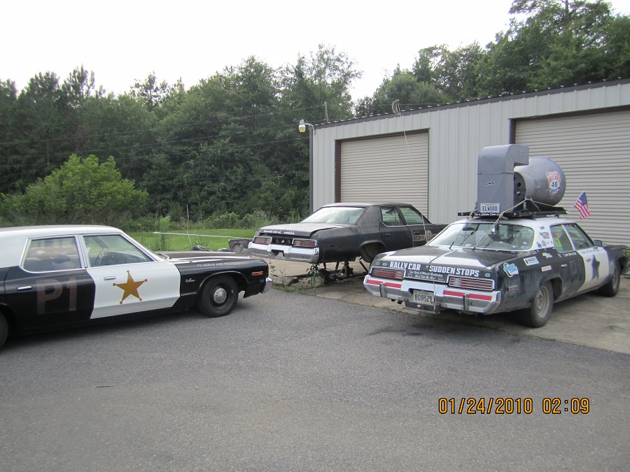

Good news is found all the things to put Blue-Too over the top as a clone K car. Bad news is donor car ain't no donor as it is a real K code. Sheriff George Teague personal car and one lady civilian owner who recently passed. Bone stock with new parts all over it as family tried to get it running. Just has an air leak in fuel delivery system so loses prime. E85 440-4 with 9.25 posi. and D36 727-b torque flight. Some of the options F35 spotlight (missing), F58 RR reinforce frame, G11 tint glass, H51 AC with heat, N21 air pump, N96 high alt tune (maybe why it runs so bad in Louisiana LOL)Will clean, tune and leave as a running driving survivor. Sheriff Phish

There’s that darn rubber mat I want! Well, lets find a vendor to use it as a pattern as it is in excellent shape. Also, Sheriff Teague must have had his shop added a fuel delivery system if he encountered a constituent out of gas. I have never seen this before. Hard pipe fuel line to front of car where you remove a threaded cap and screw in a hose to deliver fuel to another car. Anyway, we just timed it and tuned carb. Almost perfect but has a leaky steering box and oil sending unit, so this winter fix. Friggin' nice car. Even the ticket light works. and there is some weird lock blockers on rear door locks. Keep prisoners from locking car? ? New to me. Attachments:
