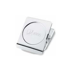

I have it mounted to a stand/bracket which holds to the center hump. This is the brand of bracket: * Workman Electronic Products #C-520You can find them on the bay for pretty cheap. No screws necessary. It is two pieces, bolts to the sides of the PA, and the saw teeth dig into the carpet enough to hold it in place. For the mic holder, I used a square office spring clip: I used a Dremel tool to grind a section from the top, front center of the clip, (to rest the rear knob of the microphone into) and then clipped it to a slightly open ashtray. .
Post by sigmfsk on Jul 27, 2011 16:18:58 GMT -5
For the mic holder, I used a square office spring clip: I used a Dremel tool to grind a section from the top front center of the clip, (to rest the rear knob of the microphone into) and then clipped it to a slightly open ashtray. I love reading stuff like that. Ingeniously simple perfect solutions.
