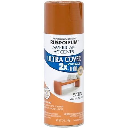

I have recently discovered what I believe is a nice color for "most" of the interior pieces. It is less expensive than the other options, designed to bond to plastic, and readily available at any Home Depot. Rust-Oleum, Satin finish "Warm Caramel" I am currently changing the interior color from light tan to brown. I have used this paint on every interior piece, with the exception of the seats, upper door panels, the dash pad and the headliner. (It even worked well on the steering wheel) Because those remaining few pieces are soft vinyl (and want to be extra careful with the headliner) I am using the SEM Camel, for those.
